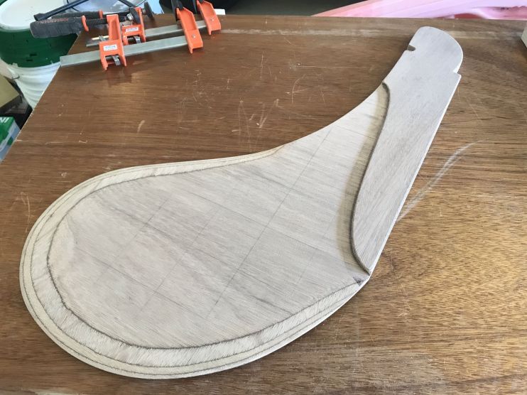

3/2/21 – While waiting for the Dynel to be delivered, I decided to start work on the rudder and daggerboard. The first step is to draw the grid from the plans onto the rudder. Then draw in the extent of the taper.
I then planed and sanded the rudder into a foil shape.

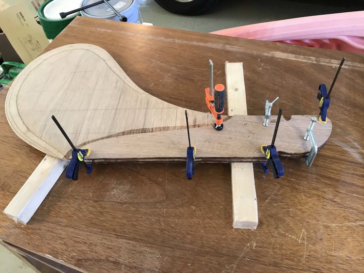

3/4/21 – Glued up the rudder cheeks.
3/6/21 – Removed the clamps and did a rough sanding on the rudder.
